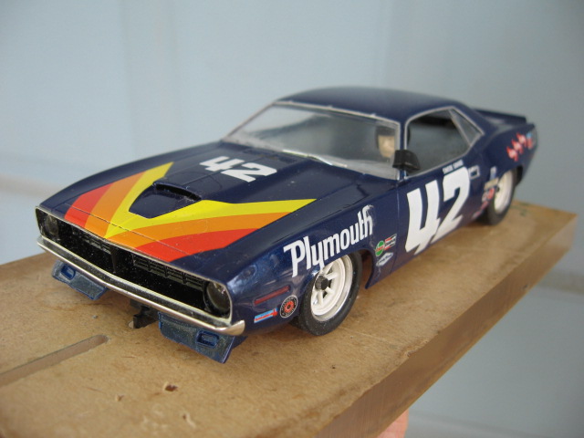

Picked up an SCX Plymouth Barracuda body from a local racer. Was a failed scratchbuild attempt with the body hacked and covered with glue smudges all around including the windscreen. No matter, it's still one of the better Barracuda/Challenger bodies done in the recent past and going to raced.
Curious on how it'll run with a sidewinder chassis layout and FF050 slimline motor.

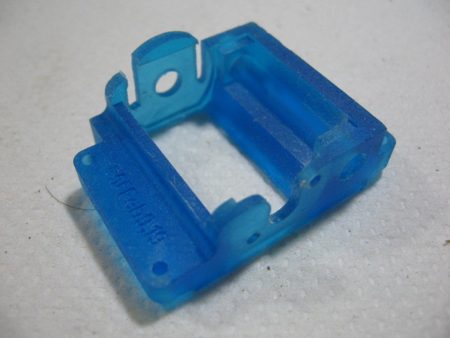

- 3D printed sidewinder FF050 motor pod

Postby 4424ever » Tue Jun 04, 2019 4:10 pm
Dan is that motorpod on thingyverse or is it a file you guys have? Watching this one with interest :music-rockout:

Postby VTECFOUR » Tue Jun 04, 2019 7:16 pm
The motor pod was designed and printed by Greater Vancouver Slot Car Club's 3DRon, the resident 3D whiz.
Ferrari 312P Coupe build
It's a work in progress having gone through a few iterations and there's further changes to go.
I rather like the FF050 motors, so having this pod for a sidewinder application is a big plus.

Postby VTECFOUR » Thu Jun 06, 2019 10:11 am
Chassis's assembled and running.
Motor's geared at 3.3:1 with a Slot It 11t, 6.5mm pinion and 36t, 19mm spur. Rolling on Slot It 15 x 8 rims with Slot It rubber at the front and PG urethanes out back. Think they're the tall 20085.
Runs really well but we'll see after mounting the body.
Mocked the body on and shooting for this stance.
Final body mounting next.
Dan
VTECFOUR
Posts: 1208
Re: SCX Plymouth Barracuda - re-chassis
Postby VTECFOUR » Fri Jun 07, 2019 10:55 am
All done.
Mounted the body with single posts at the front and rear, installed resin Minilite wheel inserts and taped in the previous owner's simplified flat card interior/driver tray.
Took a bit of inner rear wheel arch grinding and tire re-profiling but got them tucked in with no rubbing.
Usually install chassis side pans for additional weight but car runs fine as is, weighing in at 88 grams.
Ran a comparison with my modified SCX Barracuda (stock plastic chassis, Slot It boxer 25K motor, Slot It gears, TSRF guide, 98 grams) and the new build comes ahead on my twisty short wood track, topping out at a fastest 5.856 second lap compared to 5.972 seconds.
Good outcome on all fronts.
Dan

Postby VTECFOUR » Sun Jun 16, 2019 6:44 pm
Too curious to let alone, so added .032" flexi chassis side pans for body mounts, removing the single rear.
Couldn't run a faster fastest lap at 5.930 but can run more consistent fast laps for a better median over a race.
All three body screws are set loose. Some adjusting of the motor pod screws may shave off a few one hundredths.
Dan

Postby VTECFOUR » Sun Jun 23, 2019 12:17 pm
Got a S can version of the same motor pod, so going to try that.
Coming to the conclusion that the FF050 slimcan motors are better suited to lighter cars weighing less than 70 grams. This build's a hefty 99 with the added side pans.
Dan
