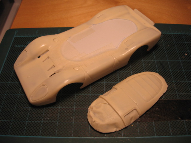

My coupe turned out well, so I'm giving a Spyder version a go.
Cut the roof off one of my resin casts and covered the gap with an undersheet of thin .015" styrene sheet to conform to the subtle body curves.
Glued in another .015" sheet this time shaped and fitted to closely fill the opening.
Working out so far.

That's looking pretty sweet. What glue do you use to glue the styrene to resin ?

Applied Lepage Super Glue Ultra Gel after sanding both glued surfaces.
Reinforced the underplate with JB Weld fast setting epoxy for some extra strength.
