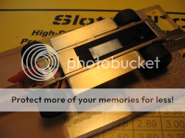

Postby VTECFOUR » Wed Apr 19, 2017 8:27 pm
Chassis's assembled.
For small car builds, I like to use wide tires in the rear. Hence, the use of the narrow Devised Designs super slimline motor pod for FF050 motors.
Should be running soon.
Dan

Re: Porsche 914-6 build 3
Postby SuperSlab » Wed Apr 19, 2017 9:38 pm
That sure looks good Dan! Two quick questions:
1. Is that like a "torsion bar" setup you have on the side pans for body float?
2. Will we see the completed car in action at Luf's on Friday?
Alwyn
SuperSlab
Posts: 687
Postby Audi1 » Thu Apr 20, 2017 4:40 am
They look attached to the main frame rails to me; held in place by the bent piano wire; also, no sign of body pin tubes. I think he's going after peripheral weighting with the side pans, to gain more traction on the rears and to gain cornering stability from the chassis platform itself.

Postby VTECFOUR » Thu Apr 20, 2017 7:39 pm
Only change from my usual chassis is the side pans are now attached to thin piano wire and soldered sparingly to the square brass main rails. Copied this from Chris W's Chevron Targa Proxy car. Has some flex, more so than when I soldered entirely along the sidepan/main rails.
Body's mounted now with single posts, front and rear.
Stance is good. Really like the look of those round sidewall March 761 urethane re-pops.
Car runs well. Will test run tomorrow on Luf's Big Targa and compare to builds 1 and 2.
Just cosmetics left to do, Fuchs wheel inserts and a driver figure on top of the motor.

Postby chrisguyw » Thu Apr 20, 2017 10:53 pm
Nice work Dan :clap: ......I hope it runs as good as it looks !!
On your next build, you may want to consider a couple of slight adjustments to your design.........hope you don't mind me making a suggestion or two.
To illustrate,I have attached a couple of shots of chassis' that I have built using the same pan attachment method that you have used.
Next time, try having the legs of your front pan support piano wire "L's" facing towards the front of the chassis not the rear.......this will add to the chassis flex. (You have faced the rear "L's" towards the rear of the chassis which is perfect).
You may want to add a cross brace to the chassis pans.......this will be soldered to each pan, but, not to the main chassis rails. You may need to solder a bit of brass sheet/tube/square to the pans so that the cross brace just clears the main rails.
To be honest, using square brass tubing as your main rails is not the hot tip in building a "flex" chassis......unlike piano wire, brass does not have a "memory", so , when flexed, it tends to bend, and stay bent, and, more importantly, it does not flex as uniformly as wire.........so brass has 2 strikes against it when building a "flex" chassis. ;)
If you substituted some .055 piano wire for your 2 main chassis rails, the chassis will flex/work better , and stay straighter longer!! :dance:

Postby VTECFOUR » Fri Apr 21, 2017 12:31 pm
Ah, what chassis beauties! I cling to the adjustable wheel base feature but the all piano wire advantages are acknowledged.
Chris, on the inline chassis, what's the piano wire diameter of the L attached to the rear of the side pan? And does it fit into a brass tube (1/16?) with some looseness?

Postby VTECFOUR » Sat Apr 22, 2017 12:19 pm
Can't explain it, but I got a definite improvement with build 3. Almost a tenth and a half fastest lap. Fresher tires? Slightly wider rear track? No matter, it's better!
Piano wire info's all in so moving forward.
Going to re-chassis my Lola T160 build 3 with piano wire main rails. Being facilitated with Retro Racer's fabricated slimline motor bracket. New thread to be posted.
