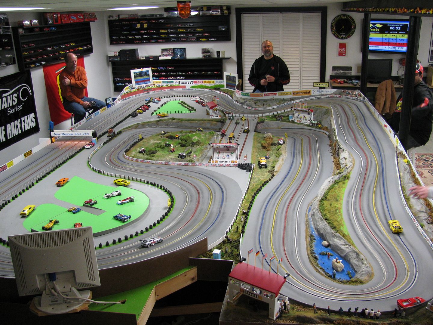

Postby nhdungeonracer » Tue Jan 10, 2017 9:37 am
In my experience, if you're building a track with different elevations and other "technical" sections, you're better off to hunt down the 3/8" MDF.
It's easier to work with and to "twist" into place than 1/2".
Yes, cutting the slot at 1/4" leaves only 1/8", but that's all you need. Just be kinda careful while handling it.
As you've already found out, you can't get the 3/8" stuff from Home Depot or Lowe's. You need to go to a place like National Lumber. I got mine from them as there's one in the next town over from me. Had to order it as well.
If the track is going to be fairly flat (like Allan's), than by all means go for the 1/2" MDF that's readily available.
Here's a track made from 3/8" MDF. Note the elevation changes...and the Laguna Sega style drop turn you're looking for :D
Re: Finding 3/8" MDF board
Postby Rleog » Tue Jan 10, 2017 11:34 am
Thanks for the reply, Dickie.
I've raced once at Marc's track. It's great....a lot going on there for a driver on a well thought out course.
My planned layout will be a modified "L" shape with a length of 20'. I'll need about a 10" drop at one end of the long straight. The steeper the decline, the less of the long straight used and the more skill demanded of the driver. The upward climb at the other end can be gradual. At least that's the way I see it.
