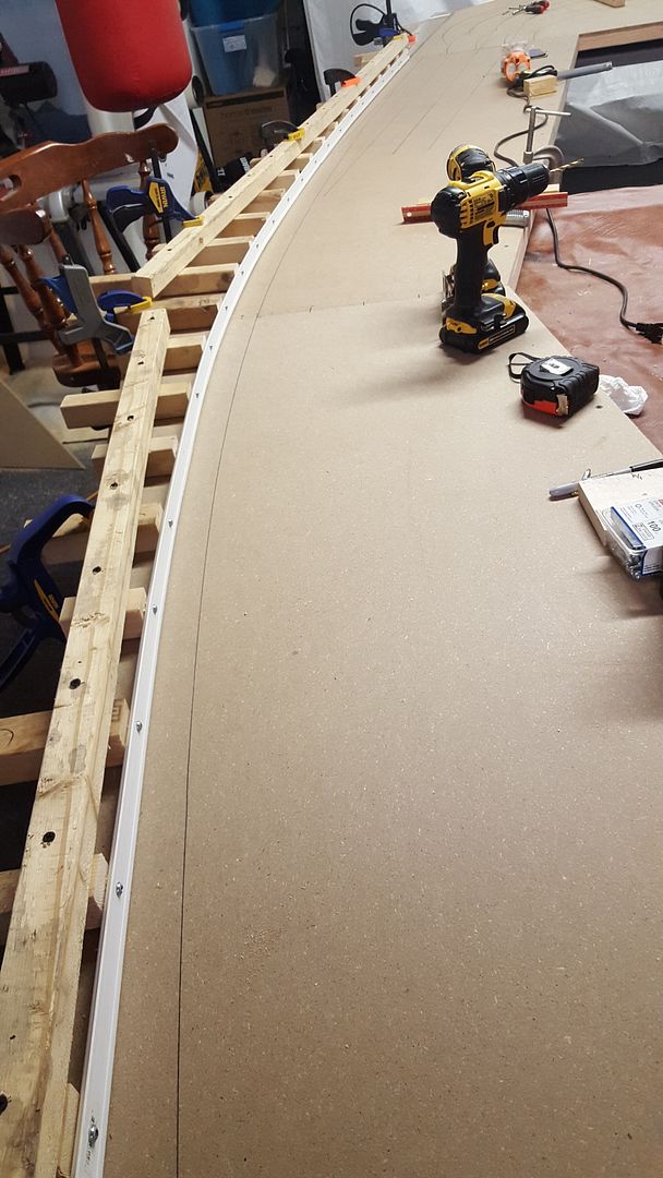

I was able to get lane 4, turn 2 of the tri done this morning before heading to work. I did tweak the jig a bit and it worked perfect, I first made sure that I was ok where the lane would run and after marking it, I pulled the jig back clamped it down and began routing.
I should get the last three lanes done tonight, then it should be ready for paint tomorrow.

Hey, I like that jig set up you have there.
I'll have to put that in my memory bank for a later date...
Thanks for sharing that! :text-bravo:

I am trying to understand how the router guide is working for the front straight, but I have a question. Can you release the clamps and then re-shape the guide to do your inner curves? Can you change the amount of curve in your guide without taking any screws out or do you have to remove screws bend to the new curve and then screw if back together??
thanks doing a great job

mattb wrote:I am trying to understand how the router guide is working for the front straight, but I have a question. Can you release the clamps and then re-shape the guide to do your inner curves? Can you change the amount of curve in your guide without taking any screws out or do you have to remove screws bend to the new curve and then screw if back together??
Yes you would have to Matt. I did it this way as I didn't have enough clamps to hold each 2x2's this time, I also had the frame already attached as well.
I did it with just the clamps when I built my last track and they could be repositioned as needed, so it was much easier. I just elevated the mdf so I could clamp the 2x2's. The vinyl strip is very flexible and available at home depot for around $10 for the 12' piece.

Thanks for the clarification. Good idea.
