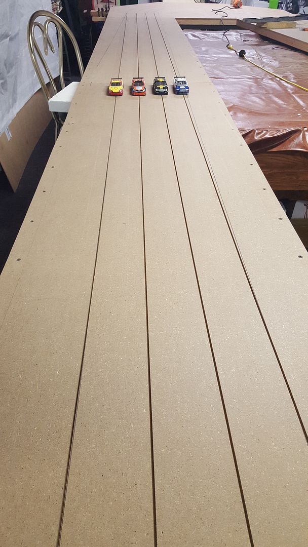

I got the two ends done today and also got started on the straight sections. I marked the lanes to give me an idea how it would look, I am going with 3 1/2" lane spacing since I run mostly 1/32 cars.
I ripped some 2x4s to build the frames and to make each section lighter, since it will be a portable track.

Tom, each end is 4x6 the straight sections are 14'x8' and the tri sections are I would guess just slightly longer then the straights. I will be going with 3½" lane spacing with 7" borders around most of the corners.

I have a 4'x16' routed oval track. It has 3.5" lane spacing. I found that to run my 1:25 cars I have to use lane 2 and 4. 3.5 is just very tight for most new racers. 4" would be best if you have new to slot car racers.
Just my 2 cents worth.

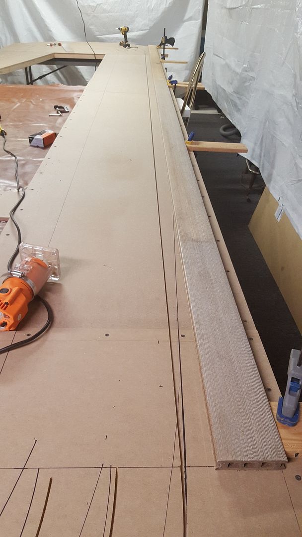

Postby Tycosaur » Mon Nov 16, 2015 11:26 pm
I was able to route turns 1 and 3 yesterday and got the straightaway done today. After building my first deck this summer, I remembered that I had a few pieces of composite decking that I could use for the fence to route the straight section.
I attached a couple of pieces of scrap wood to the sides of the decking then clamped it down. This worked great as it can be moved easily if the slot lines are off. The picture looks as though I've made some routing mistakes, but there just lines from a sharpie as I was trying for some different lane paths.
I got all four lanes routed quickly and straight doing it this way. I also couldn't decide to go with 3 1/2 or 4" lane spacing, so I routed turn 1 with 4" spacing, turn 3 with 3 1/2" spacing and turn 2, the tri will have 3 1/2" spacing as well.
I will be routing turn 2 tomorrow using the same type of jig I used that required no nails to route my first track.
