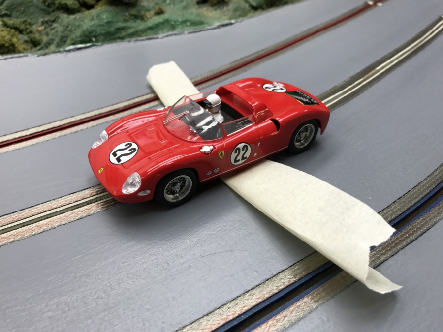

The third is by far the most common and most effective. Maddeningly simple, it is nothing more than wide pieces of masking tape stuck to the back of a car and trailing behind, sticky side down. I was showing off my converted Zamboni to some folks (LED lights all over it, and pulled by a matching color Fly truck), and my guest picked up the tape I keep handy for cleaning tires, stuck a couple of pieces on the back of it, and once around the track (where I had just cleaned!), showed how much I left behind. Hardest to swallow of all its excellent properties, this method is also fun. The faster you run the car, the more crap is kicked up by the drive wheels, and the tape catches it even better.

1. Billions of hours of research have shown this to be an outstanding product. In fact, some use it for other purposes. You can even roll tires across it to clean them as well.
2. Very cost effective. $2.00 and you have a 1 year supply or more depending on use.
3. It collects it ALL. There is no dirt particle or dust bunny safe from this method.
4. Even cleans the tops of the rails/braid.
5. No special attachments needed.
6. Available in a wide variety of colors and patterns to suit your taste.
7. Available globally and located in almost every retail store you walk into.
8. No residue or chemical left behind.
Happy Cleaning :)
