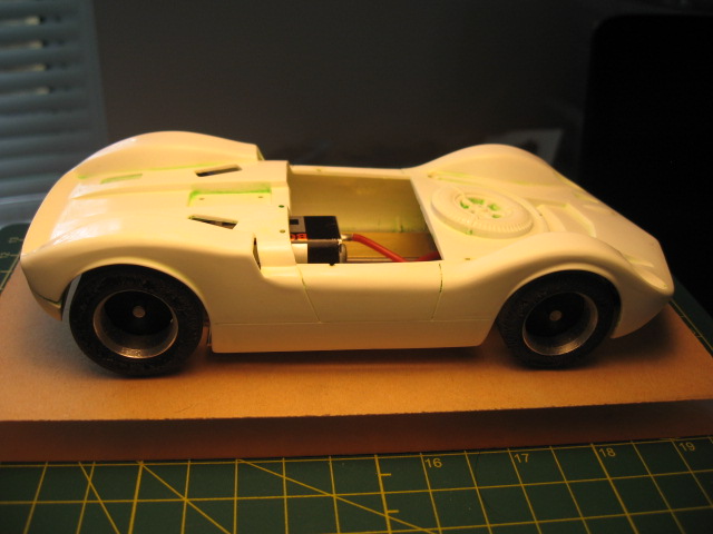

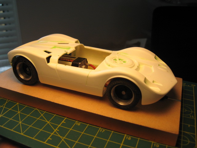

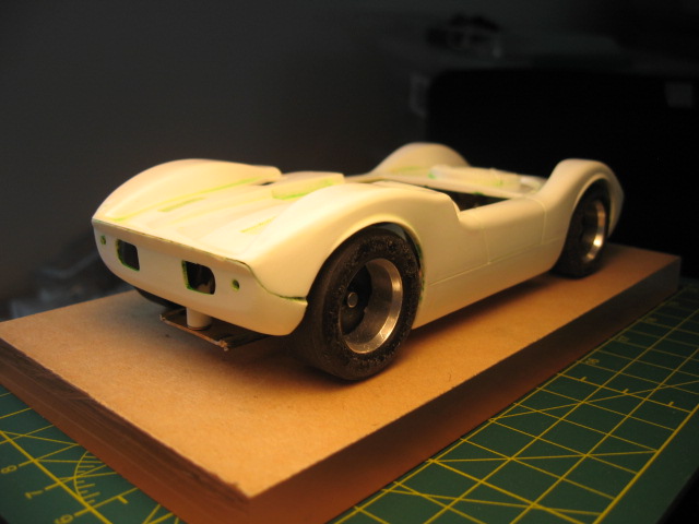

My stripping of an old AMT McLaren Elva body with soaking in 99% isopropynol alcohol for 24 hours was a complete failure. Started sanding in frustration but knew the little crevices and details would never be cleaned well.

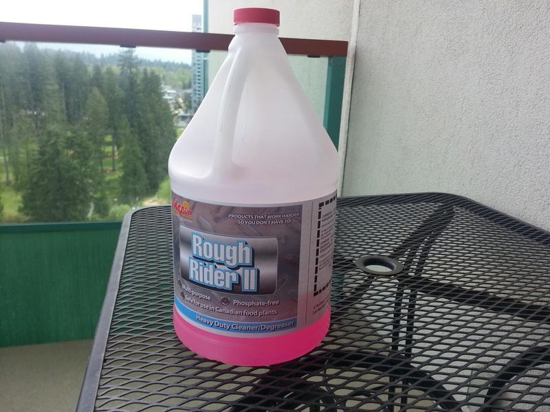

Mentioned this at my weekly Model Building Night get-together and was was lent Rough Rider II degreaser by Maxim. One of the guys uses it at work on marine ships and swears by it as a paint stripper for models.
After six hours submerged in a small sealed container, the paint came off with a light toothbrush scrubbing.
There was negligible residue in the bath so I recycled and poured the degreaser back in the container.
I'm impressed and will be using Rough Rider from now on for paint stripping.

Noticed that the label makes a Canada reference so wondering if it's only available up north here. Was borrowed so not sure where it was bought. The product info makes a boat reference so those suppliers should be looked into.
An online search shows some Canadian retailers, but the price looks high compared to the readily available Super Clean.
In the end, it works.
