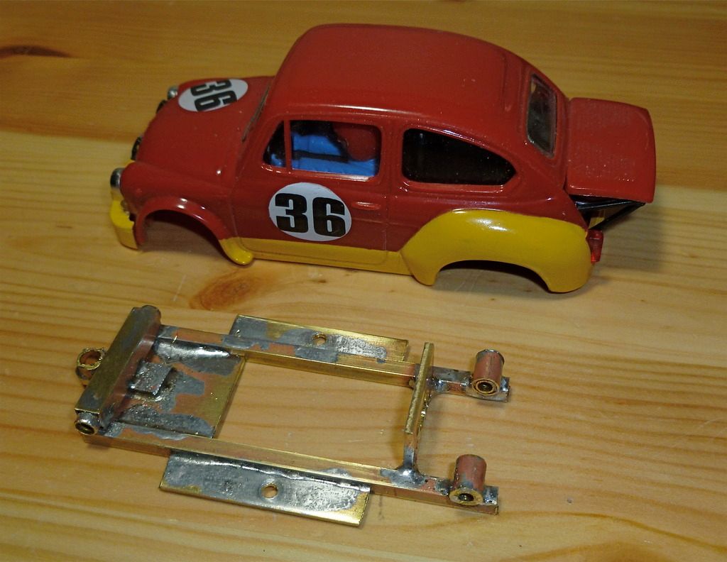

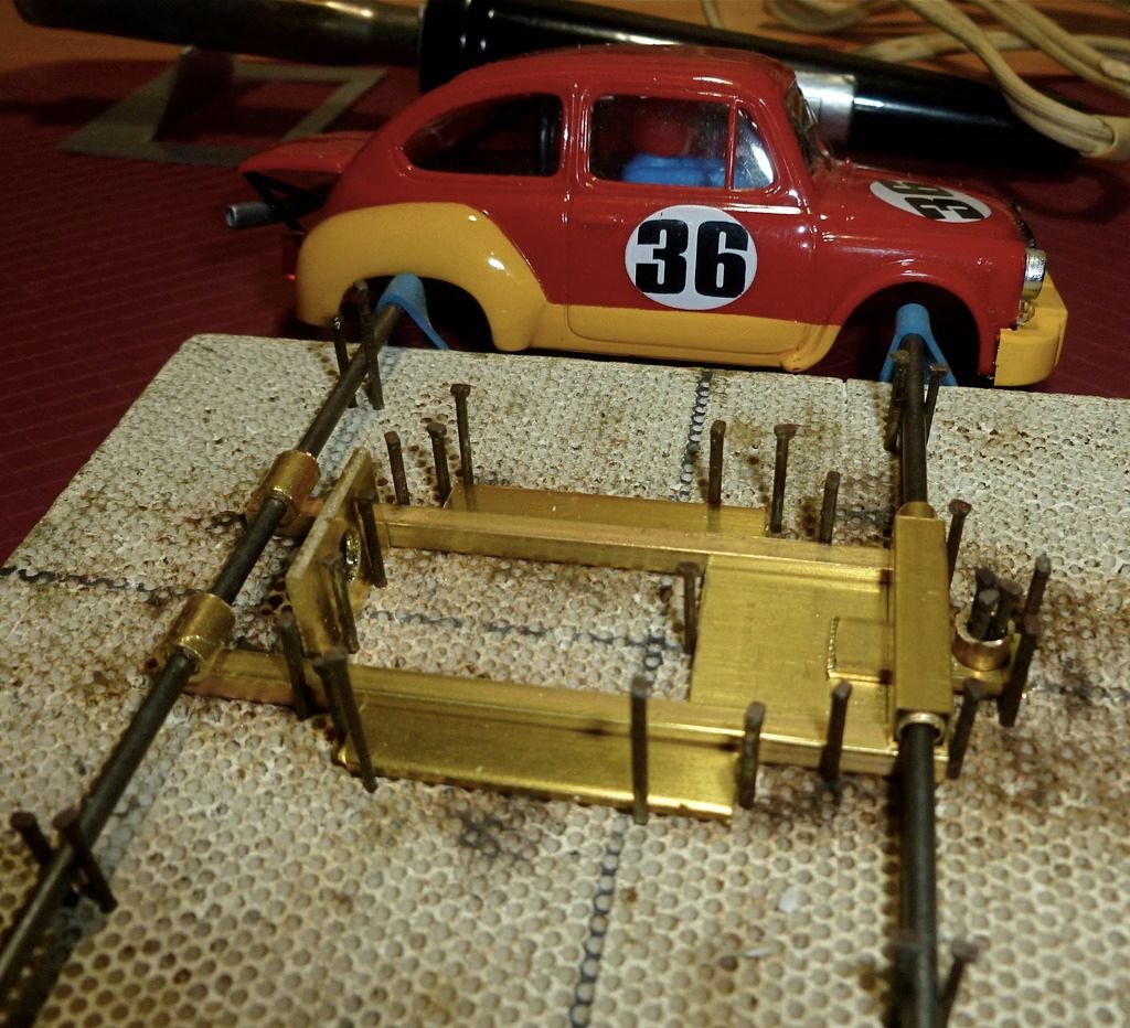

I decided to post another picture of a chassis for a Reprotec Fiat Abarth. No, the one that starts this post didn't break, and is still a regular on Luf's hill climb.
It is a bit of a long story, but it started when my friend and club mate, Don, offered to paint the body of my Mod Wars car for me. He has an airbrush and likes painting. I was thrilled and immediately agreed, but then got to thinking that I should do something for him in return. I had noticed that he had a couple of little Abarth bodies looking lonely in his shelf, and offered to build him a brass chassis for one of them as a thank you for the painting.
As usual, I laid out the brass pieces on my honeycomb board, and pinned everything down. I took a picture and it looks like this.
I made a couple of refinements on this one and it went together very quickly. The motor mounting plate was one I had already made (I made about a dozen or more at one time) and changed the front plate by using 1/4 brass for the guide tongue. The axle tubes are three sizes of brass tubing telescoped together. My trusty 50 year old Weller did its job and now the chassis looks like this.
It is now ready to be delivered, and he will add the necessary hardware.

Postby McLiams » Wed Mar 25, 2015 3:52 am
Some very impressive work and extremely well presented. Obviously, you have been doing this for some time with so many builds under your belt. These questions are just based on neophyte speculation. Is there any induced 'bridging' of the steel 'axle' rods, used to hold parts in place, when the elastic bands are installed? Would sliding the wood spacers out to the edge of the ceramic plate help to negate any (if there is any) tendency of the rod to arch up ( and possibly) displace parts?
Again, this is just a couple questions from someone who has never fabricated a brass chassis...but would like to try someday.
McLiams
Posts: 257
Joined: Fri Mar 20, 2015 3:41 pm
Re: Chassis building on a honeycomb ceramic plate.
Postby Retro Racer 44 » Wed Mar 25, 2015 12:48 pm
Hi McLiams;
I have built these cars using the wooden strips along the outside and also without, and haven't noticed any difference. 3/32 piano wire is quite stiff, and doesn't bend over these short distances. I often use it for the axles on these small cars also, I haven't got the heart to cut down a Slot.it axle. The piano wire axles work well, as long as you cut it right through and resist the temptation to bend and break it. That would distort the end and could give you a wobbly wheel.
If you've never built a brass chassis, get yourself a honeycomb board and the nails, and you will find it becomes very easy. I built a lot of chassis back in the 60s without any kind of jig at all, and they were always slightly wonky. This method is very easy as it holds everything in place until all the solder has hardened. I try to avoid soldering piano wire as it often doesn't hold as well, but brass solders up really nicely. Some people would want to get rid of the extra solder visible on my chassis, but I don't mind the extra weight, and it is all on the inside.
Give it a go, you'll find it easy. If you have any other question, fire away.
