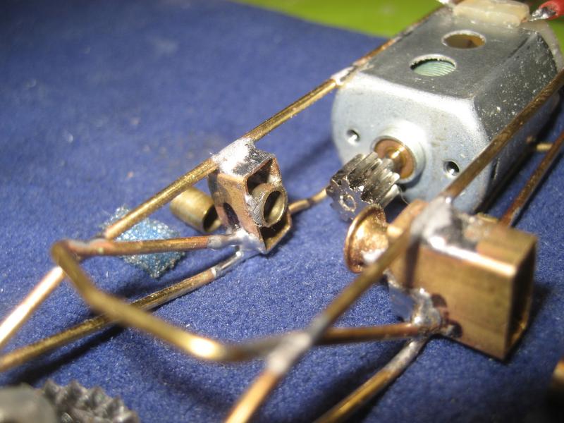

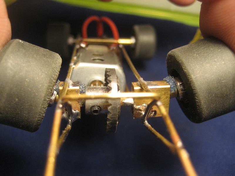

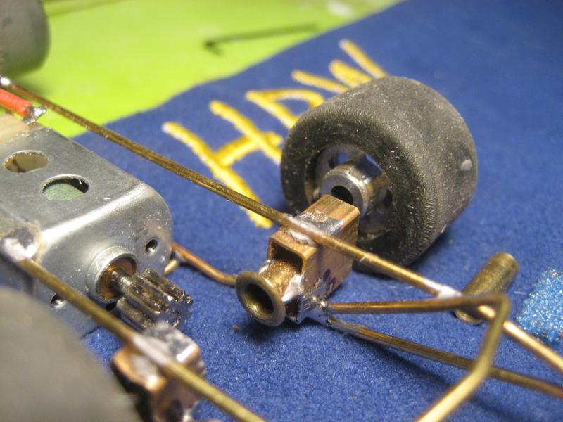

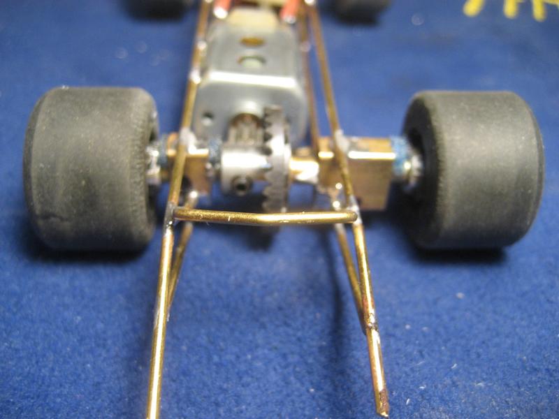

Too hot to play outside last couple of days, so I thought I'd build something that's been in my head
for a couple months.
I've tried several times in the past 3 or 4 years to build a rear suspension with moderate results.
I'm giving it another try.
Here's the pieces it took to build this version:
The axle is a piece of 1/8 universal speedometer cable, which is an extremely tightly wound
tempered spring; (All you gearheads will know what I'm using here)
I'm using various lengths of 5/32 brass tubing;
& 2 small pieces of foam;
I'm using a piece of 11/32 (I think) brass rectangular tubing on each side of the chassis to mount everything.
..........This is an offset chassis for oval racing...after all this is, Strangebrew......... :D
I've barely inserted a fluted (might help the gear ride against it a little better) 5/32 brass spacer
into the right side rectangular tube & soldered.
Same procedure for the left, except it's a VERY SHORT piece of regular 5/32 brass tube.
This locates the axle in place in the chassis.
All that's left is to assemble the pieces.

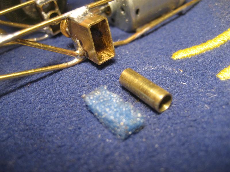

I put the 5/32 brass tubes into the rectangular mounts.
These act as bearings for the axle to ride in, but also can rotate in the rectangular tubing.
so you sort of have 2 bushings in one.
I left them extend past the outside just slightly so as the axle moves up & down, it won't bind against
the outside edge of the rectangular tube.
The axle has barley any front to rear movement & is only allowed to move up & down.
The foam was an afterthought to help dampen any chatter from the axle. (My version of a shock absorber)
It runs good on my short oval with no discernible wheel hop. Guess it needs a test run at "headquarters".
The axle is pretty stiff, so I don't even know if it works as suspension or not, but it was an interesting project. :roll:

Strangebrew,...Nice to see you experimenting/tinkering,....it is a very cool part of the hobby, and one which not only is fun, but, really improves ones building skills,....wish more folks took part.
Over the years many cars have been built with independent suspension systems, and Ulrich produced a very highly engineered/complex chassis with 4 wheel ind. suspension (and front end steering) in the mid 60's....it did run quite well, but its complexity/over engineering made it very heavy, fragile, and uncompetitive. I have yet to see/hear about a car with ind. suspension that has been competitive with a traditional solid axle car, although chassis with torsional flex certainly rule the roost in terms of handling. That said, I again applaud your efforts, and do not let anything I have said deter your efforts......very cool to see !! :clap:
One thing on your build you may want to consider......you may want to insert a solid shaft into the spring going laterally from (and into) one bushing support to the other.......this will still let the ends of the axles flex, while eliminating any flex in the center of the axle, which will lead to gear mesh/wear issues, issues which will affect the handling of the car.
Build on and have fun :dance:
Chris Walker
PS..In case you have not seen one, a couple of pics. of a Vintage Ulrich chassis
A fairly simple front end .........note the real wire wheels,...these were from Russkit, looked great, but not very true, and really really fragile !!
A more complex rear end using springs, half shafts, universal joints etc.
Note:....the axle between (and into) the bushings is a solid piece, eliminating gear issues
