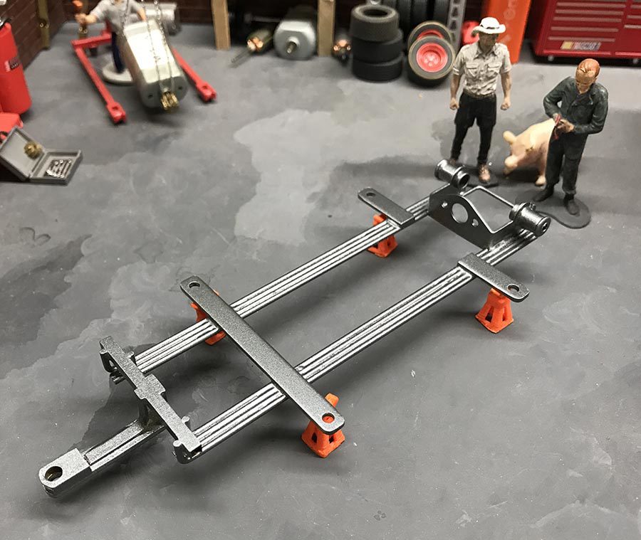

Postby HomeRacingWorld » Sat Sep 09, 2017 8:24 am
Here is a couple of my simple chassis.

Postby gascarnut » Sat Sep 09, 2017 8:36 am
Real nice photos and those black frames look really cool!
What paint do you use, and does it stick well to the brass? Any special process to prep the brass?

Postby HomeRacingWorld » Sat Sep 09, 2017 8:46 am
Well thanks sir.
It's Duplicolor Perfect Match series lacquer. I find mine at Auto Zone.
I clean and prep the chassis using those nice abrasive "scrubbers" I like to call them.
My final prep will sound very odd, but it works. I take the chassis and spray it down with inexpensive "Lime Away" in a spray bottle along with a little Dawn liquid. I scrub it lightly with an old toothbrush and rinse. That removes any oils left behind.
Then spray away. Just a few coats. Yes, it sticks pretty well, but it does chip off here and there over time with hard racing. But most of my chassis still look fine.
