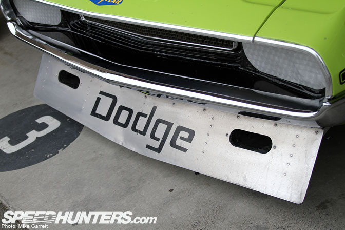

Postby HomeRacingWorld » Thu Jul 16, 2015 3:37 pm

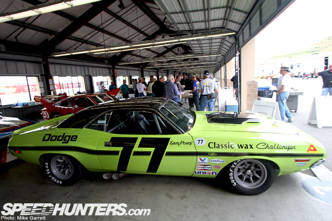

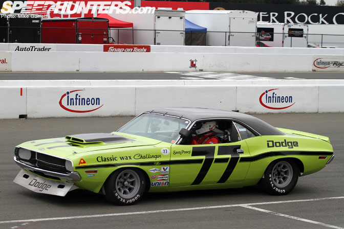

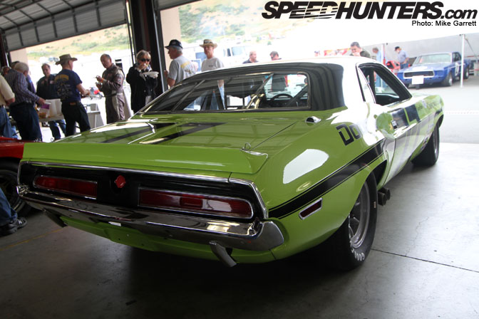

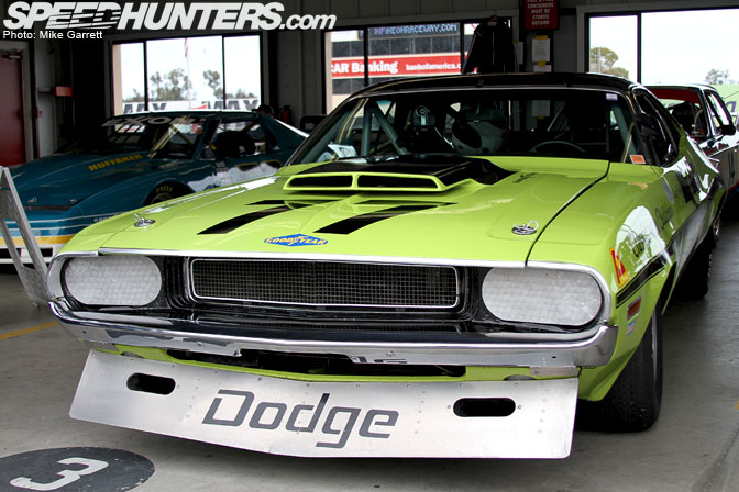

Just for reference. Taken from Speedhunters.
Re: Challenger Reference
Postby waaytoomuchintothis » Thu Jul 16, 2015 3:46 pm
I have a couple of white kits I need to get busy on. Excellent reference material, as usual, Harry. Thanks.

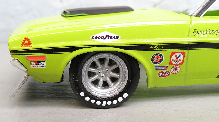

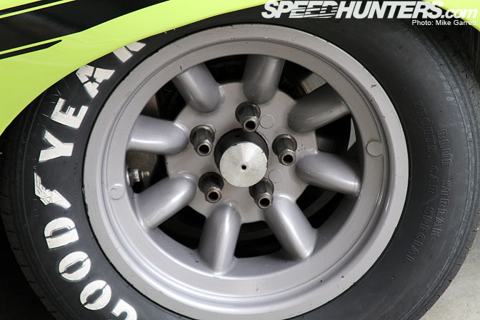

Did not like the looks of the stock fronts. Too small to my eye. Decided to change things.
The 20105 was too low a profile. I used the 21 size and turned them down in the Razor until I achieved the look I liked.
Used Duplicolor Perfect Match for the color. Seems to look ok.
Used a BRUSH to fill the seams at the outside edges of the insert. It filled the gap nicely this way.
Toothpick lettering and a coat of Future. Fine Sharpie for lug detail.
Sitting as mock up, but I like it well enough.
Postby waaytoomuchintothis » Thu Jul 16, 2015 5:40 pm
Yep, that was one of the major details I didn't like about the Scaley car. Those wheels are not robust enough. The other thing that bugged me was that the wheel/tire combination didn't fill the fender the way the 1:1 car's did, and the Scaley chassis-mounted exhausts didn't have that tasty flare like the real car did. I have been toying with making my own chassis instead of using the Scaley one, but I may just modify the Scaley to do what I want it to do. I have been going back and forth about the paint, too. This is one of those cars that have a color shade that is better exemplified by Duplicolor than by Testor's, Tamiya, or Model Masters (also Testors). I still don't have a decision about that. It would be a foolish expense to buy all of them and compare, since there will only be three cars that I ever intend to paint like this. I have some great decals, and the other things I would fix are easy to do.

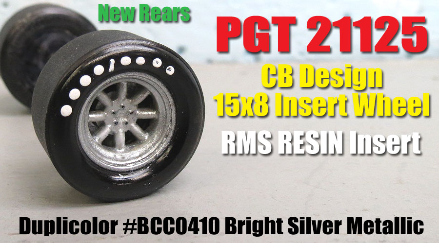

Thanks guys. Kind of turning into a "Semi Live" coverage event, so here are the rears.
Same wheels/paint/technique. Just 21125's instead for that slightly wider patch as it should have.
