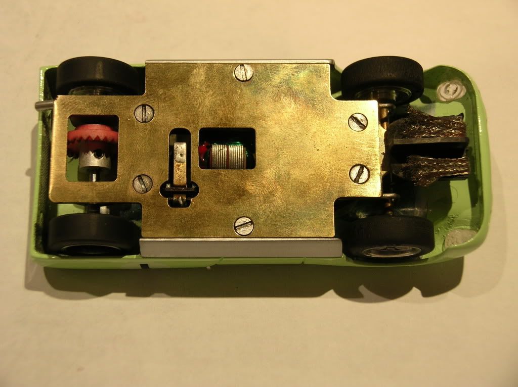

Thanks for the kind words Alan, I have included a few chassis shots, but, I am afraid they will be somewhat disappointing as most I tried to keep somewhat stock, and a few are used in our club's 50's/60's sports car class which mandates a plastic chassis.
The boring stuff first...this is the chassis for the dino spyder.....club rules mandate a commercially available plastic (non podded) chassis, and this is a PCS with a front axle tube mounted.

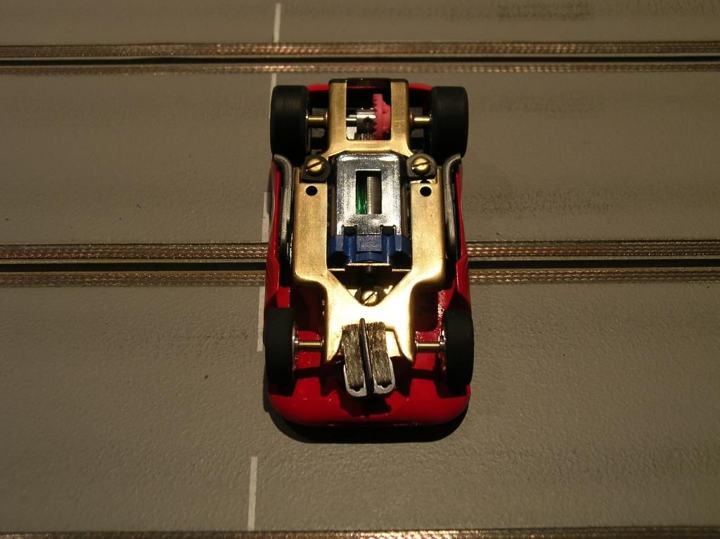

Next is the Cheetah(s) with the Strombecker "pro" brass chassis....by far Strombeckers best.....and with work are very quick.

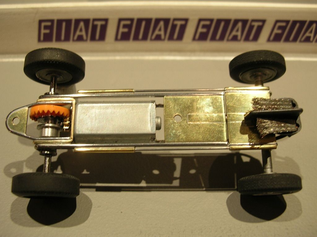

The Ford J has a similar chassis to the following pic.,..........a much modified Monogram, (lots of bracing, and a heavy pan), with a completely reworked 16D "tiger x 100" motor. A very seriously quick little chassis, and, a monster motor.

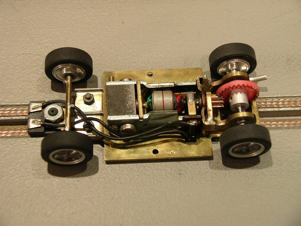

The RS 61 runs in our "scratch" sports car class, a has a flexi board chassis......
