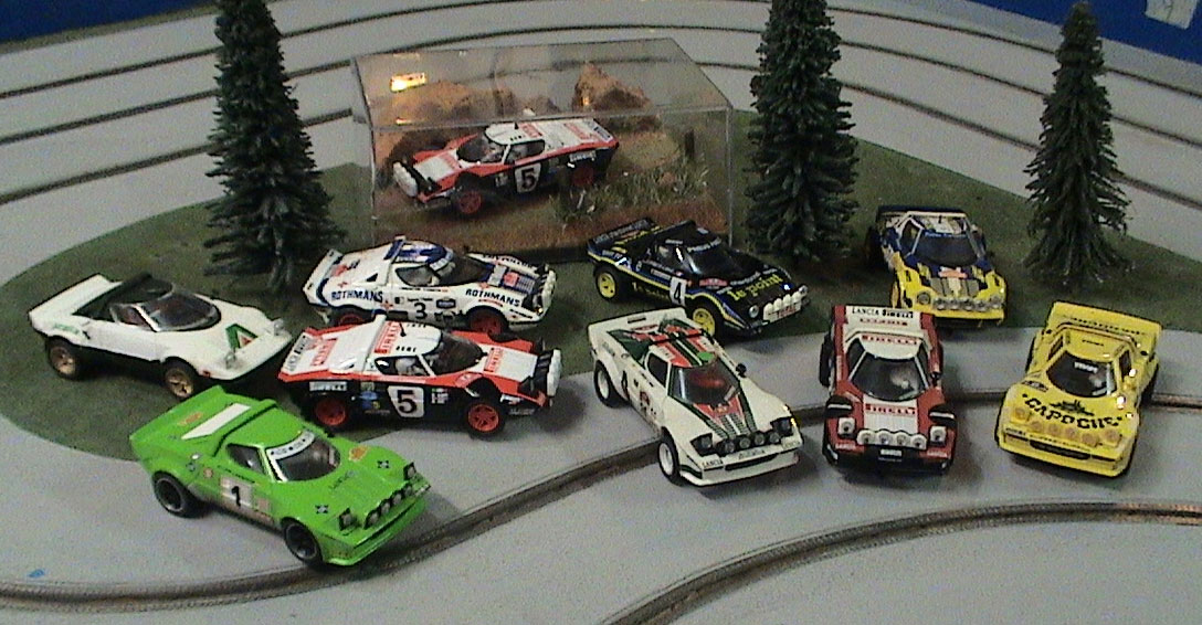

If you are a fan of road rally then there is no excuse to not hunt down this car for purchase. The Lancia Stratos is the most important car in the history of rally. The Stratos was the first car to be designed solely as a rally car. Prior to this rally cars were road cars that had been converted to rally trim. The Stratos was equipped with the left-over motors from the Ferrari Dino's - 190hp V6. The Lancia Stratos driven by Sandro Munari was a FORCE! Stratos won the world championship in 1974, 75 and 76 only to be removed from the field by FIAT in favor of the 131.
I have all of the major brands with cars from Team Slot, SCX, Altaya (SCX) and now Ninco. The Ninco is by far the best car out of the box. Not even close. I have a pair of the Pirelli's and have the Alitalia on order.
Go Stratos!

Great collection, KV. :)
The Stratos is kind of a big deal, and one of the coolest of all the Italian wedges of the 60s and 70s. It's mysterious how it's been pretty much ignored by the major slot car makers in the last 10 years (until now). TeamSlot carried the torch as best they could, and really did a decent job, but it looks like the Ninco car is just better all around.

Postby kidvoltage » Fri May 24, 2013 2:29 pm
You are correct, that would be Embers spectacular work. Keen eyes.
