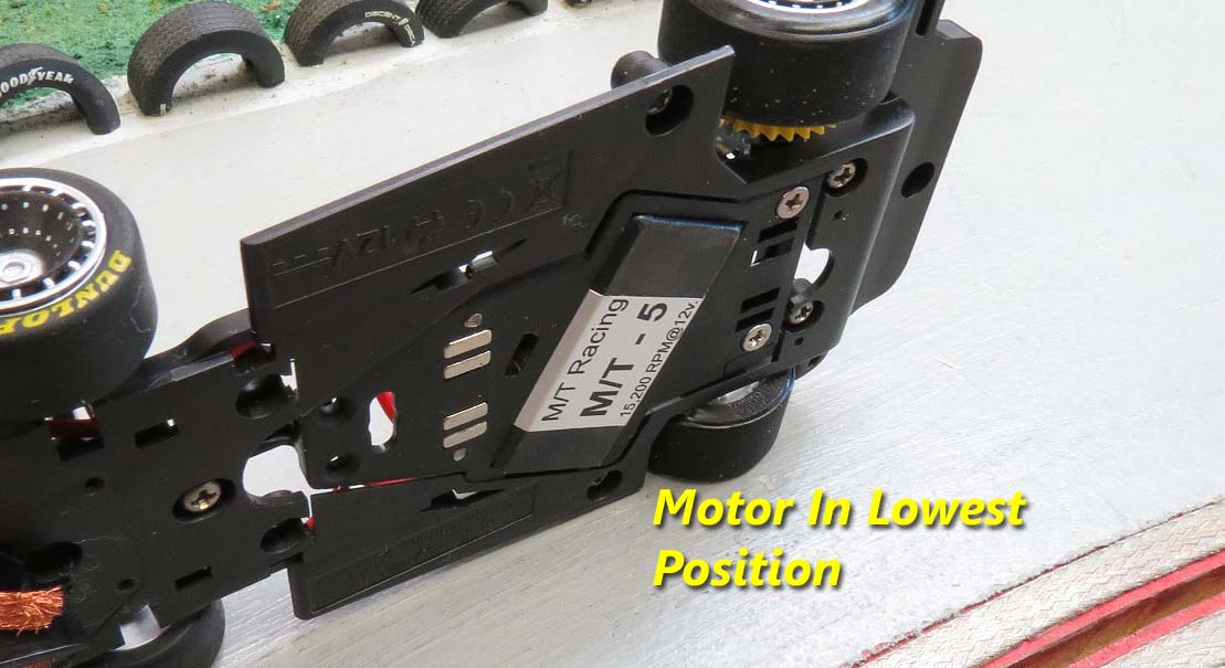

Decided to have some fun this evening and tune this car to match the rest.
I did try the "Hard as nails" adhesive Paul talked about. I went over to "that area" in Wal-Mart and found it quickly, and left.
It goes on nicely and I let it sit about 1/2 hour.
Razor time. I use 1500 grit and took my time.
Remember that if you use a slightly larger tire, you will need to sand the inner sidewalls a little. These anglewinders don't give you much room so in order to fit a little more meat underneath, you sometimes have to massage things.
MT5 is our motor of choice for these car on our track. Everything else but the PG tires is stock.
I mount the motor using the lowest setting to make sure it clears the interior and to get it as low as possible for balance.
Not bad times: 3.82 average after a few 25 lap heats. That is very consistent with others in the class around here.
Fun time with this car this evening. Runs like you would expect.
