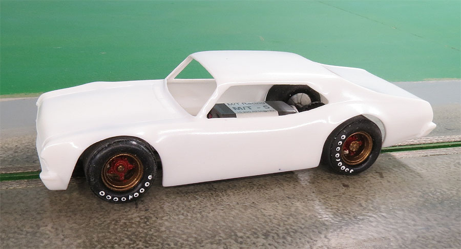

So it's all together and doing a little "break-in" Sing it with me: "She's a Roller"

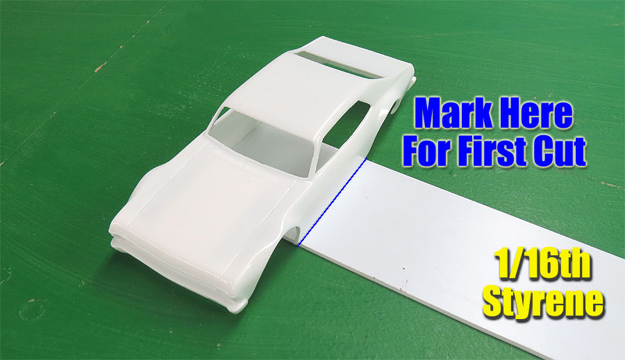

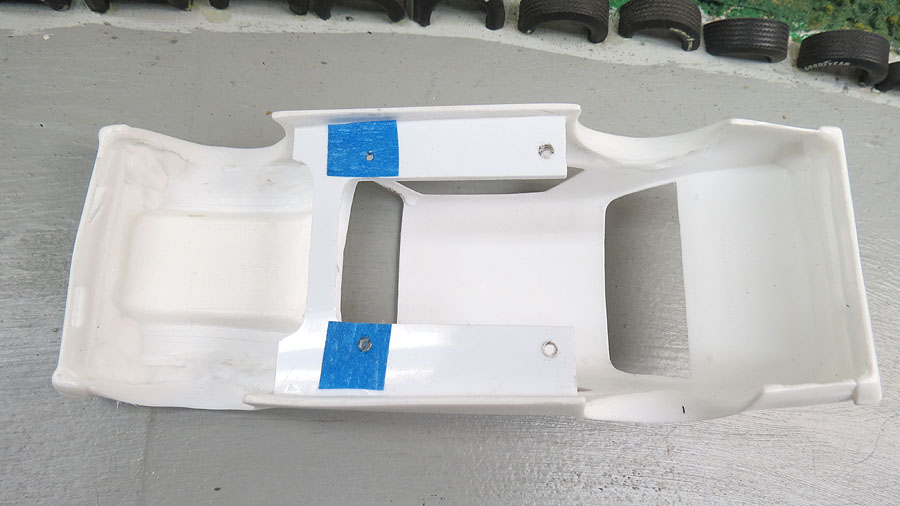

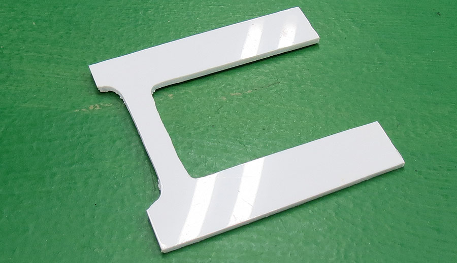

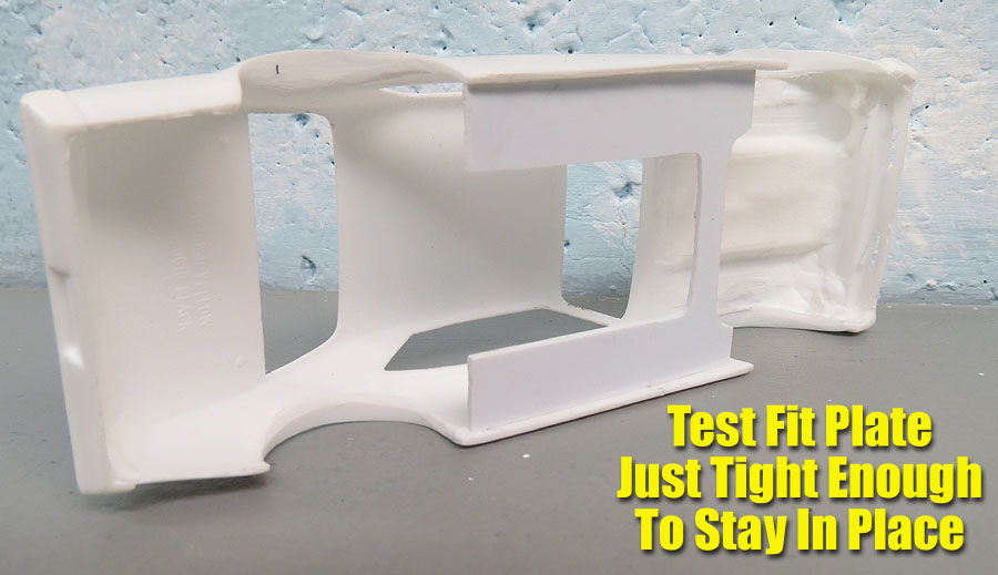

Time to make our mounting plate. All of you mount a body differently, this method is just what I like and am comfortable with.
I take the body and place it over the plastic I am using. I then mark the area where I will make the first cut. After that I start to sand and contour it until it fits on the chassis cleanly.
Of course I grind away the openings for the motor and this case, the front guide tongue support brace.
Yes sir, looking ok.

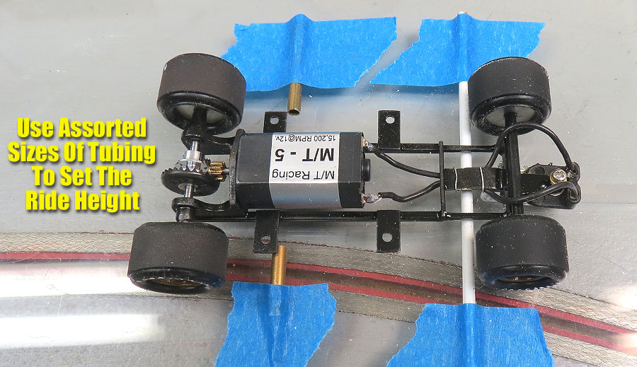

Now for the sides. I sand the edges until the plate is JUST held in place with the pressure of the body. This way I can move it when I am setting the ride height.
Do NOT glue yet. Time to set it right where it needs to be while on the block.

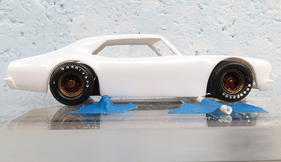

Here is how I get the ride height of the body right where I want it. I place the chassis on my setup block and then the body. I test fit different sizes of tubing for front and rear, rasing/lowering it until I get it just right. Then I tape the tubes down to keep them secure.
Think you get the idea. Now while it's here I reach in with a razor knife or small screwdriver and press the mount plate down. It will seat itself against the sides of the car. Now you can take the body off and give the plate a couple drops of super glue to secure it.
You can then add more glue along the edges on the inside and outside.
QUICK TIP: If you set it up and find out the car body is still rubbing, use some masking tape. You may not think so, but just one layer can and will make a difference.
Mark your holes for drilling and time to test it out :)

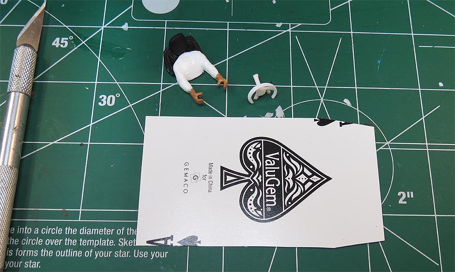

And now onto our extremely detailed and rather costly interior. Now I don't want anyone getting intimidated by my superior detailing skills, if I can do it...so can you. :whistle:
First we begin with our interior tray. Oh sure, playing cards are sort of expensive but nothing but the finest material here at the HRW Skunkworks.
Using MT Racing Driver...his noggin is around here somewhere. In any case you can see how basic my approach is.
And done. Very basic but it accomplished the mission. :) I will add more roll bar detail after the model is cleared and glass installed.

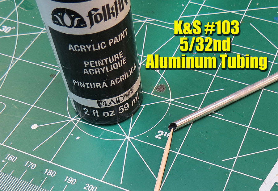

Here is a quick tip for exhaust. I like using the K&S aluminum tubing. You could use plastic just as well, I just like it because if you wanted to, you could buff this out to a really nice shine. I never do it...but you could :)
After I cut it I use a toothpick and some inexpensive acrylic to make it "dirty" inside.

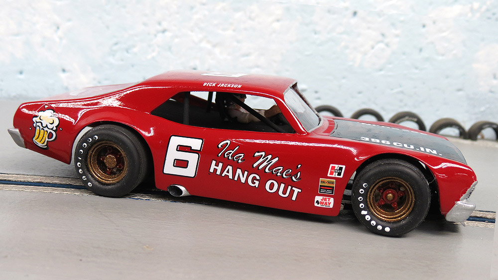

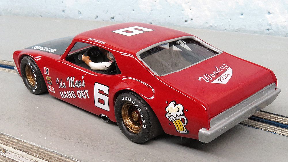

Thanks guys for all the feedback and comments. Here is the old ride ready for action.
Decals are all SLIXX. Just some fit 1/32 off those sheets and found some I liked.
Clear is Krylon Acrylic. 3 light mist coats, then a heavier final. Buffed out with paste wax. Not perfect, but soon it will have some real character.
All in all pretty happy with the model.
I'm just grateful to Mark for taking this old car and making a great looking slot car body out of it. Also to Paul Gage for the new tire size that makes it look much better to me.
We have it made boys. So many cool after-market stuff out there today that we get to play with.
Now...onto the the next one :)
