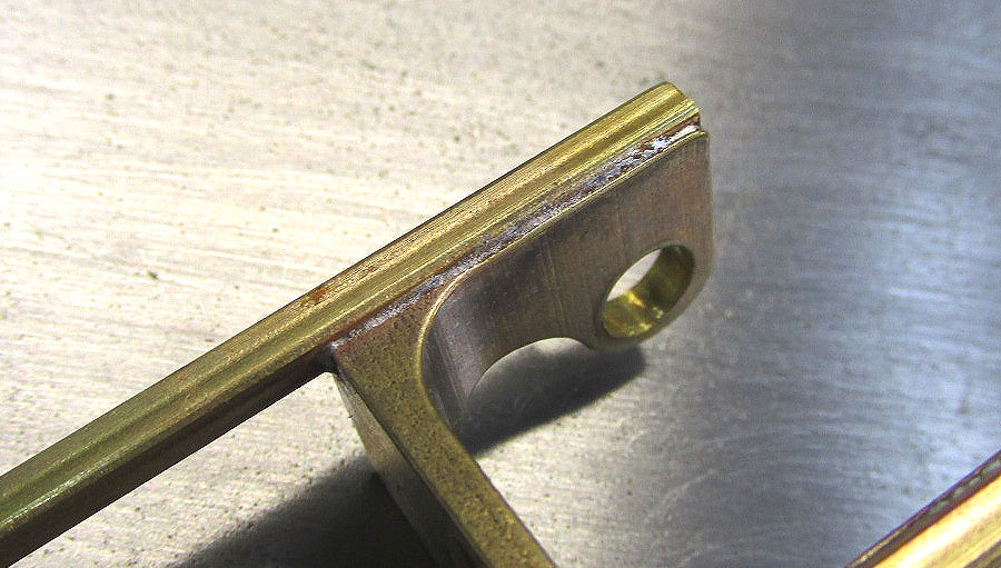

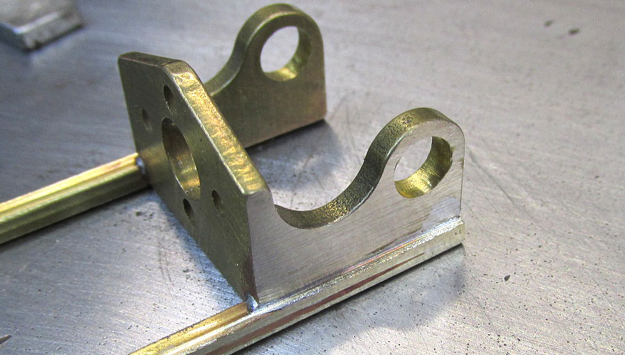

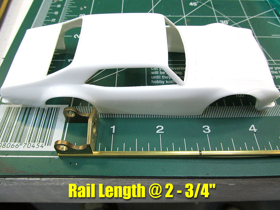

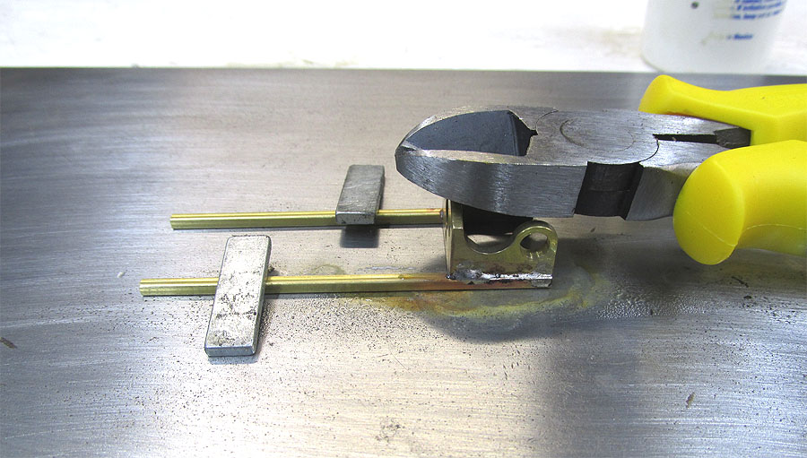

Time to measure and cut my first pair of frame rails. As you can see this is not that critical of a job. I basically set the car on my cutting mat and get a good idea how long I want it. In this case I needed about 2 & 3/4's.
Everyone has their own method of soldering. In fact, I am pretty sure it's slot car law that no one can own the same soldering iron or solder a chassis in the same method as another.

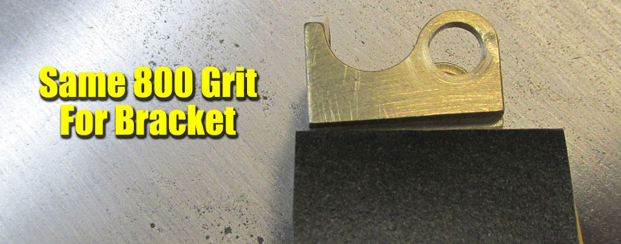

My appraoch is to first clean up the brass using some 800 grit sandpaper. This de-burrs the edges and gets the brass pretty clean so the solder will flow easier.
Here is my high tech method. And you thought slot car magnets were evil. As you can see I was a little heavy-handed with the solder. I don't care. I am not here to win any awards, so not worried that it looks rough.
I do not use an iron either. I like a torch. I use 60/40 solder and just a touch of flux to make sure it's clean. Is this the "proper" way? Well, it works for me.
When finished I flip the bracket over and check to see how the solder flowed. Usually I see what you are seeing. This is about as good as it gets in my book.

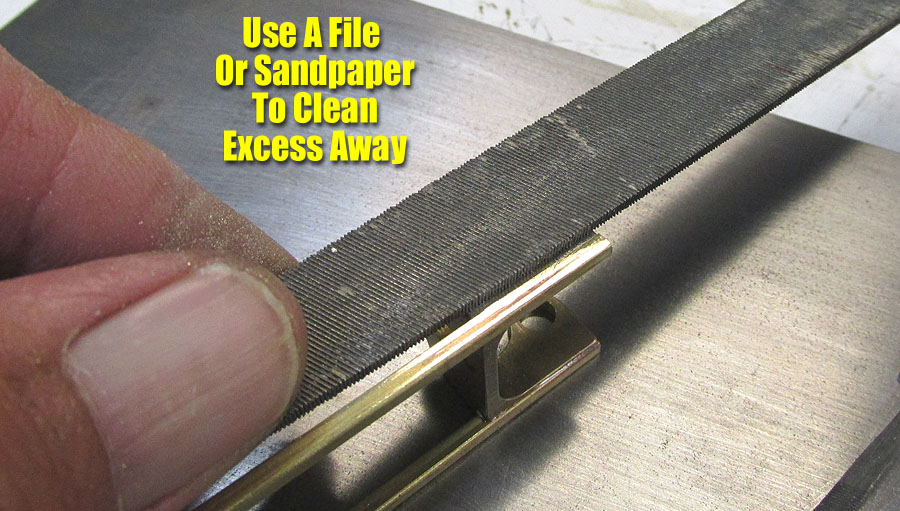

You can clean up the excess solder and make it look better using a file or sandpaper. I just like using an old fashioned flat blade file.
Looks good enough for me.

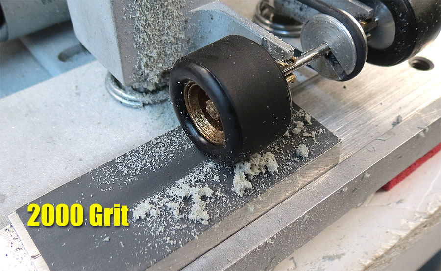

Little tire sanding method to share.
When I sand, I only do one side at a time. With PGT's I like using 2000 grit. This allows a very smooth result. Keeping the rpms at a mild level I lower it down and take slow passes.
I only need to sand the contact patch smoothly. Another thing I do is wet my finger a little with good old spit and coat the tire as it turns. This is a quick way to check and see if you have the entire tire sanded. Does it help smooth the surface? I cannot say either way. In any case, I think the result is good enough for me.

Postby TuscoTodd » Sun Jul 20, 2014 1:58 pm
SHARP on all accounts!
I like it! :D
Also like your "split" bushings on the Razor! :)
I cut a "v" out of some spare scalextric plastic ones that I pop over the axle to use, but I would be that yours do a better job of keeping things "level" side to side for axles you can't pull the wheels off of.
Thank you for sharing the picture and the detail on "how" you are truing your PGT/XPG tires. :)
