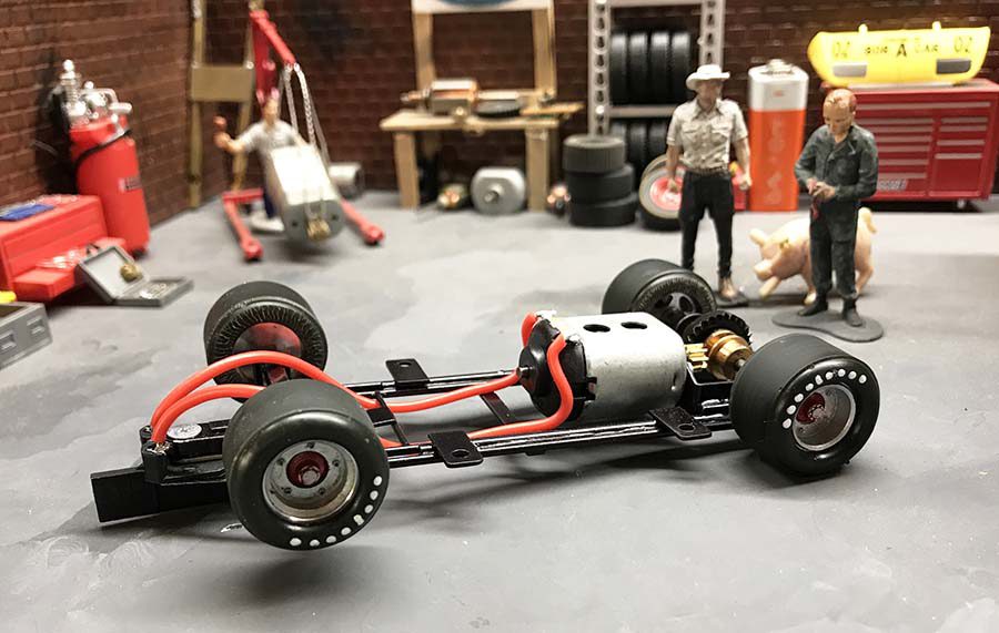

Thanks, it came out pretty good in the shakedown runs.
All standard Showdown Series gear on this one. Piranha motor, 9/27 Slot.it.

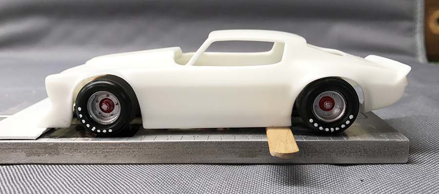

Mounted the body using my regular old techniques. I shimmed the body from the underneath to get the ride height I wanted and then slipped in the plastic mounting plates, and glued in place.
Used Evergreen sheet plastic this time. 2MM thick. I tacked in with CA (SuperGlue) and then flowed more glue after it dried.
Just a slight amount of rake.
Now to prep the body and get my paint right.

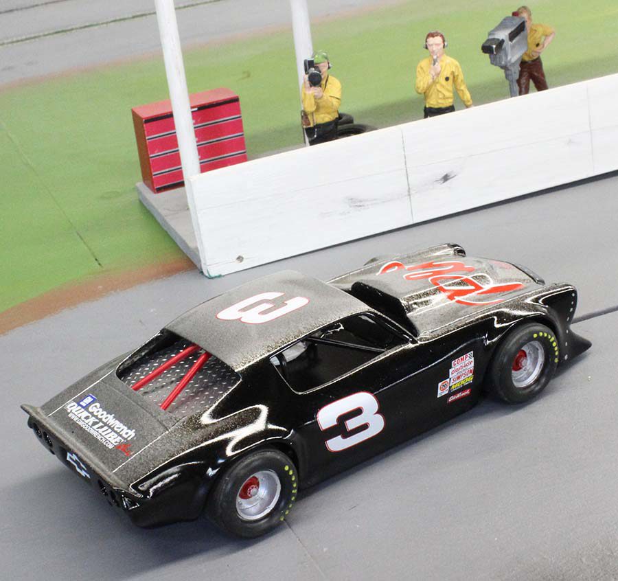

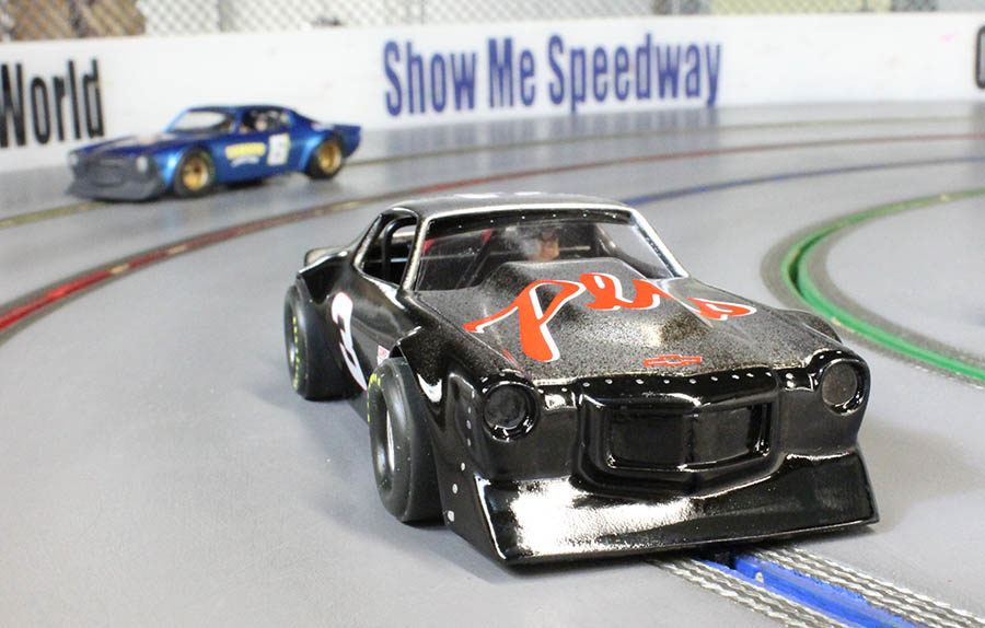

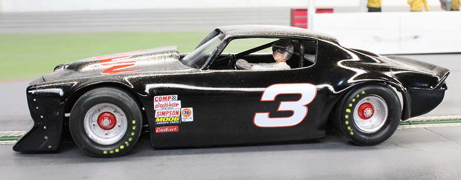

Postby HomeRacingWorld » Fri Aug 18, 2017 6:43 pm
Thanks guys - well a few more hours and countless cups of joe.
Had these decals for a long time and thought: "Why not"? Just a theme car as usual.
The General took ownership :) We had some fun tonight under the lights.
