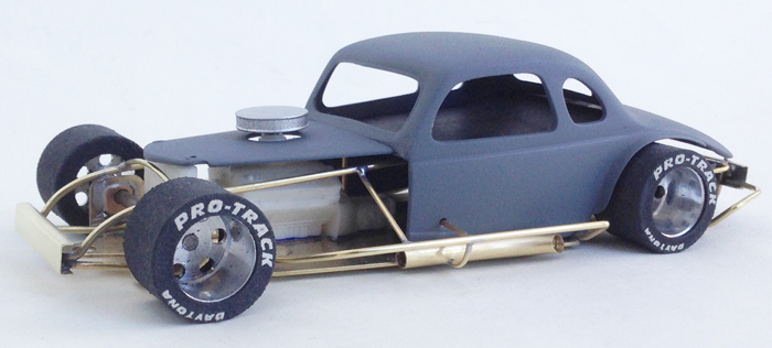

I used the 'old standby' '36 Chevy Modified kit - I think it originally was an MPC release in the 1970s, then it was AMT, then Model Car King, and then DTR... and right now it is not in production. I added in some styrene to form a cowl, and I added some back in at the rear fenders so the wheel cutouts wouldn't take "a bite out of" the rear deck lid area. I also made up some little rear fenders - all in an effort to replicate the actual car driven by "Tiger' Tom Baldwin at the famous 1/5 mile oval - Islip Speedway.
RIGHT REAR VIEW -
I added in small construction details like the brass 'over rider' on the rear bumper and the rear quarter nerf bars.
EXHAUST DUMPS AND FUEL CELLS -
I made some brass exhaust dumps soldered to the chassis, and I used a thin plastic blister pack (actually the packaging from an H&R motor) painted and double-stick taped in place to simulate the rear fuel tank on the actual car.

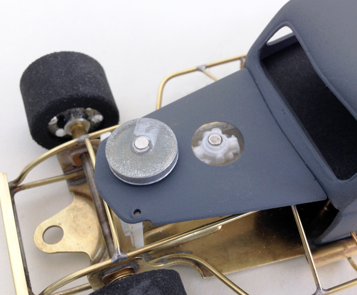

AIR CLEANER FITTED TO THE CARB -
I used two really tiny neo-magnets to mount the air cleaner. One glued in the carb and one glued in the air cleaner. This works really well, allowing me to pop it off when removing the body, and it just finds it's position magnetically. *Click* and it is in the exact correct position.

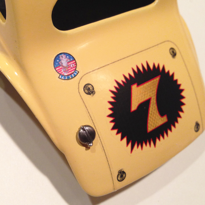

Anyway - I make my own decals, and I even offer up a few sets on the nymodifieds website (and I could scale these for 1/32 if someone was interested)...
There is a trick involved - I do not offer 'white ink' decals, so a work-around for 'non-white' cars involves using a white base decal paper as an "under layer" for the clear color printed decals that I do make.
WHITE BASE DECALS FOR THE TOM BALDWIN COUPE -
I printed out a white decal sheet and trimmed the shape and put it down in position. The white artwork conforms to the outline of the "Grumman TOMCAT" decal.
I did not have to use anything for the engine-turned gold leaf style #7 or star burst effect - they are just clear decals on the light yellow body color.
'TOMCAT' IN PLACE -
I place the 'clear' color printed decal over the positioned white base shape. The end result is a decent quality appearing decal for a specific subject.
There was a Grumman plant located about 3-4 miles from Islip Speedway - and growing up around there I saw these "TOMCAT" and "Anytime Baby!' round stickers all over town.
I guess Tom Baldwin thought a few would look good on his race car, since he was named 'Tom' afterall...
I also made up grey 'shut lines' or 'shadow line' decals for the deck lid since I didn't model/master them in. You can see the gas filler cap has been added as well...
THE CLASSIC GAS CAP -
Although not a perfectly scaled and detailed piece, this method of creating gas caps seems to have a special place with slot car builders... It has been done for like 50 years now.
Basically you solder a 1/32 brass rod into a slot headed screw and it creates a plausible-from-a-distance gas cap filler. The screw threads actually let you spin in into the styrene body, and adjust the 'stand off'' as you see fit.
I still have to blow this all apart - paint it up, add some details, clear the body/decals, and add inserts, but it is coming along...
Works for me and it is a nod to *slot car tradition*.

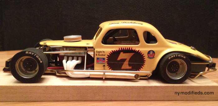

TOM BALDWIN COUPE SLOT CAR -
...Sitting on the kitchen table getting ready to race again - only this time in 1/24 scale. The color shown here is probably a little 'richer' than it actually is in real life.

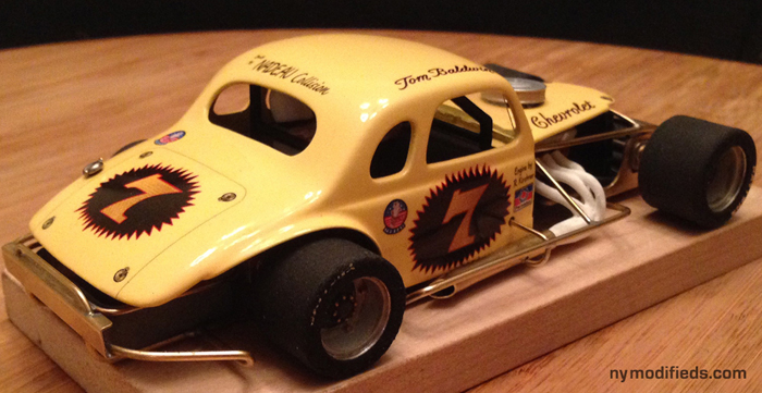

RACE CAR IN SCALE -
Again, just a shot of the Coupe sitting on the kitchen table right before running at South Shore Speedway Friday night - really cool that this car had to make its way past Artie Tappan's #14 Vega/Astre in the feature that night...
