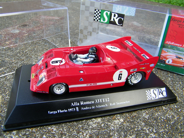

The model arrived safe and sound in what I feel, is some really nice packaging.

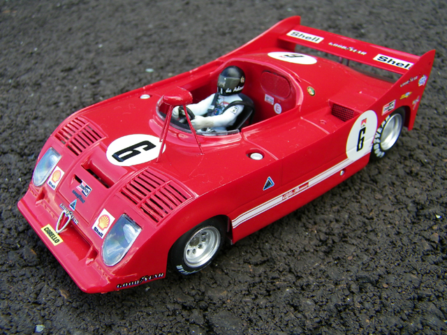

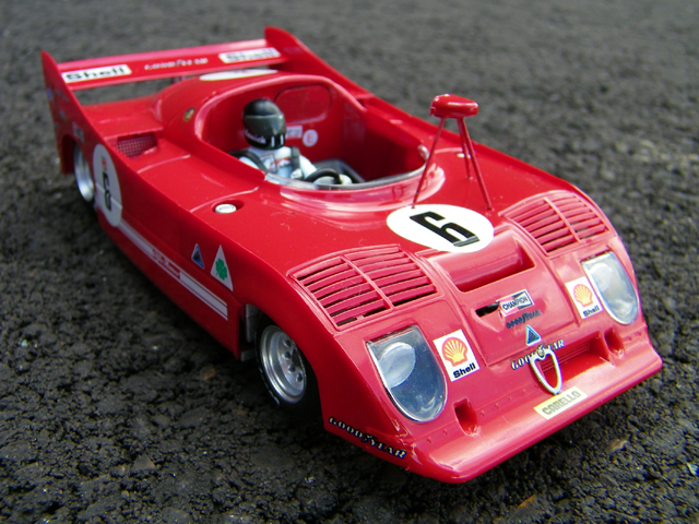

As with all slot car models, there is always some detail missing, wrong, etc., but at a glance, and comparing it to the actual racer, it looks really good.
It's nice enough for me, how about you? It'll race!

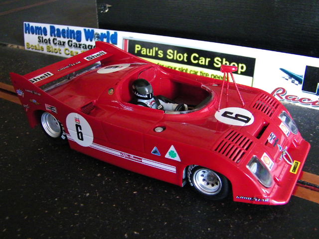

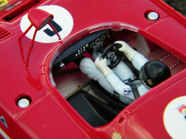

The tampo printing in some areas is off just a tad, but again, it's no more than we see from other manufacturers. I will say, that in the detail area, well, check out this interior and driver...very well done.
Have a look at that mirror! Those of you who wish to race this model will be happy to know that you can easily remove the mirror for racing and then reinstall it for displaying if you'd like.

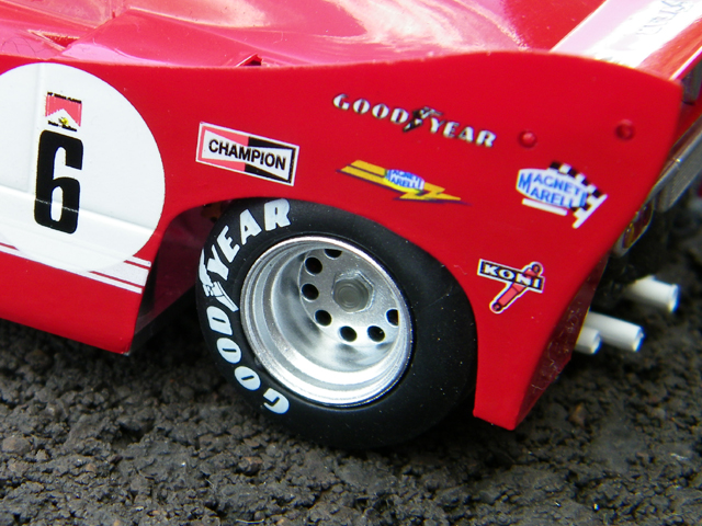

The wheels look good as do the tires which are wearing the Goodyear label.
Tires are a fairly hard compound, but they can easily be replaced with your favorite aftermarket tire. They are also rounded quite a bit across the contact patch, but with some sanding that can be corrected easy enough.

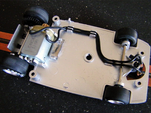

Removing the 4 screws we see a very nice chassis. As with other SRC cars this chassis comes with a solid front axle. Although some like independent front wheels/tires, I like the ease of tuning a solid front axle. When done well, it can result in really nice performance so it is a nice little bonus for me.
The wiring is routed well which saves me from having to glue or tape them into place.
The front guide fitment is good and includes a spring to keep the braid on the track when the wheels may be riding on imperfections on the track surface. I'm not a huge fan of the spring system and most likely will remove it. In doing so, I'll most likely have to add a shim to get the ride height I want.
The rear wheels and tires should look familiar. They are the same wheels found on Fly GT40 MKII models (as an example). This means any after-market tires made to fit those wheels will work here. There is still some sanding to do to remove the ever present flash molding of course.
The rear axle bushings are slightly loose in their carriers so a little hot glue is in order there. I don't use super glue or anything permanent in case I need to remove one for any reason.
The Alfa gets down the track with an 11 tooth brass pinion that mates up to a 36 tooth spur gear. The gear mesh has a small amount of play in it, but not enough to get excited about. With running, they will mesh up well enough.
As I mentioned earlier, the motor in this car seemed just right. I'm not sure what the RPM of the SRC motor is, but it similar to a classic Fly, which is in the neighborhood of 18K RPM...just enough to keep it fun and not so much it's hard to drive.
Braking is good in this car, stopping from full throttle at 12V in less than 18", which is the range I like my cars to stop in.
For the magnet racer, the chassis comes with a small bar magnet, and as mentioned earlier, there is plenty of room inside the car/chassis for a replacement or additional magnet.
