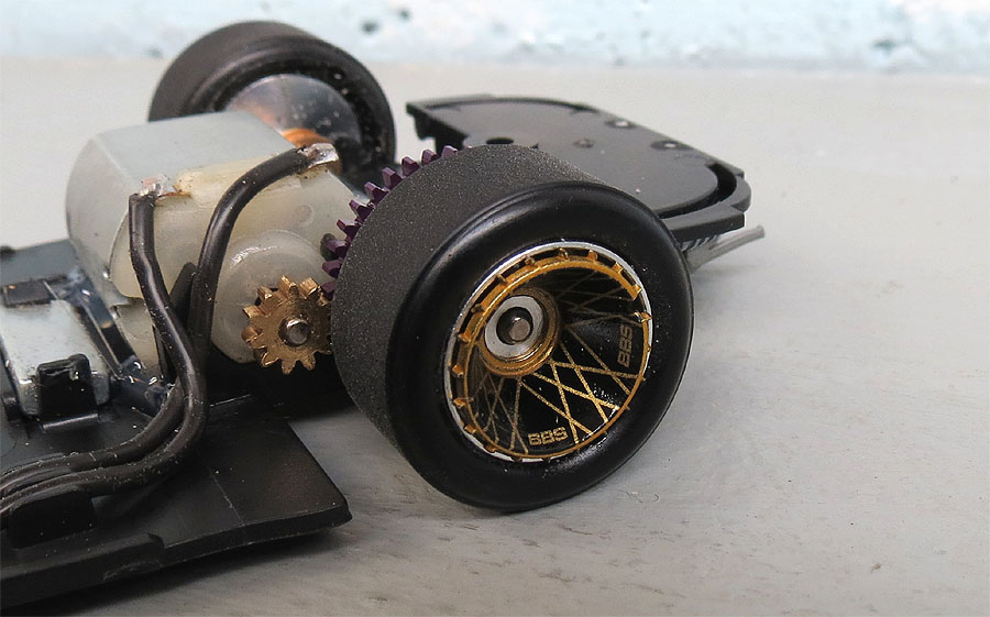

Tire Truing
No matter if you glue or not, or the method you used, it's time to true these tires up. Nothing seems to transform a model from bad to good faster than truing the tires.
As with almost all the other steps we have covered, the techniques I use will vary greatly from others you might see. There isn't a wrong way to accomplish this as long as the end result is a tire that is as round and true as you can get it.
Since we are dealing strictly with Paul Gage urethane tires, I use a very fine grit sandpaper to true them. I like this approach as it leaves a very clean and smooth contact patch.
I only sand one wheel at a time. You could do both but I am just comfortable one at a time. I am not in that much of a hurry either. Some have complained that these machines do not true both wheels at the same time evenly. This is true on all brands I have tested. Yet, it isn't always because the machine is defective. It is mostly due to the uneven tolerances we deal with. It is commonly seen on plastic wheels and stock running gear where the loose bushings and the slight differences in the mold of the wheel itself effect each side. Even the slightest thing from having tire material under your block or the amount of wear on the paper can cause it.
What matters to me is getting them true and this machine will do it. As the video shows, I just take my time until I have sanded the entire face of the tire and move on to the next.

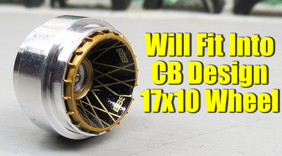

Now we are ready to install our wheels and mount the inserts.

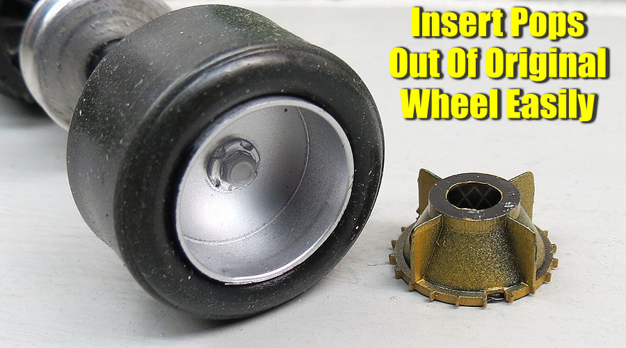

The final step to finishing this model off is to install the inserts in the wheel. With this car we are very fortunate because the inserts pop right out of the old wheel and fit nicely into the new one. I used the tip of an Exacto knife and they came out with no damage.
Use some of the clear nail polish and coat the inside of the wheel. Then press the insert inside and you are done. They fit pretty tight and you could skip the adhesive. I just did it to be on the safe side.

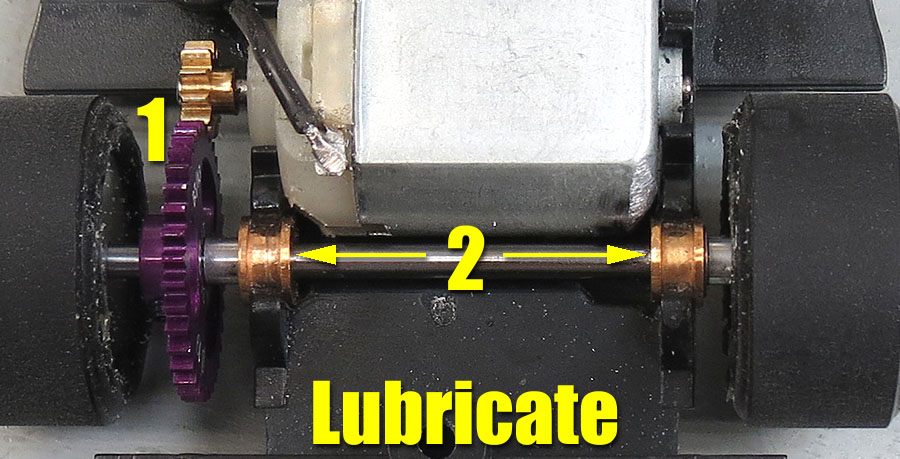

Before we begin testing we need to make sure and lubricate the areas shown above. I use the oil SCC has on hand but just about any plastic compatible oil will do.
As you can see we have a very smooth model now. The gears will break-in and smooth a little over time and you will want to add lead weight here and there to suit your taste and track conditions.
